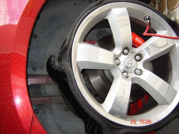

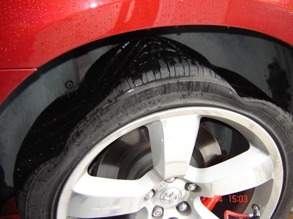

I went thru the nitrogen phase as well, too much trouble for the following reason;
In order to fill them with nitrogen, it only makes sense you'd want to get rid of the air that's already in the tire. Even at 0 psi, the tire chamber is full of air (14.7 psi's worth @ sea level to be exact). Being an HVAC contractor, I made use of a vacuum pump to remove as much air as possible. Below were the results :D
No, the tires weren't damaged in any way. But I don't think it's a good idea anyways. I did this mostly for kicks & it wore off quick enuf. Popped one tire off the bead as well, so there's a point where you really shouldn't be pulling anymore air out.
