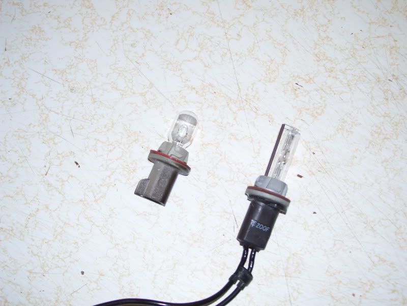

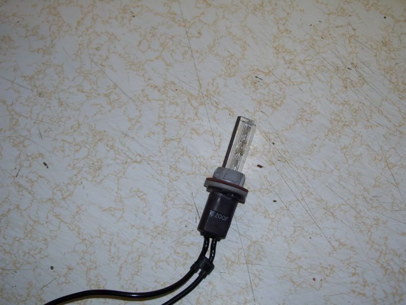

Simply take the bulb socket cut off the piece that plugs in drill it out and glue the HID bulb in place . I used a H3 since it has a small base .Hope this helps a few of you out .
Stock Base and new Hid
HID base and bulb

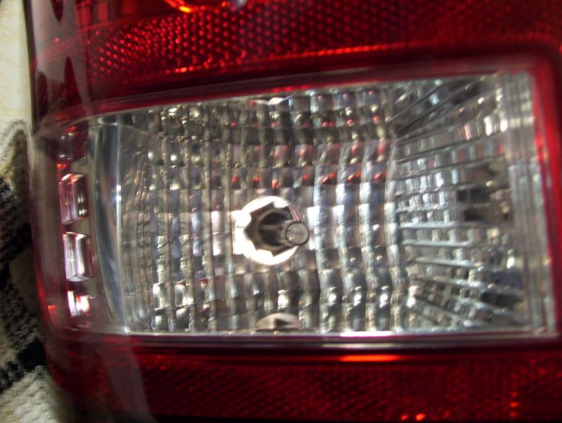

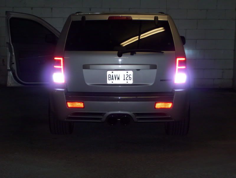

Installed water proof and looks stock
Bad pic but you get the idea
HID base and bulb
