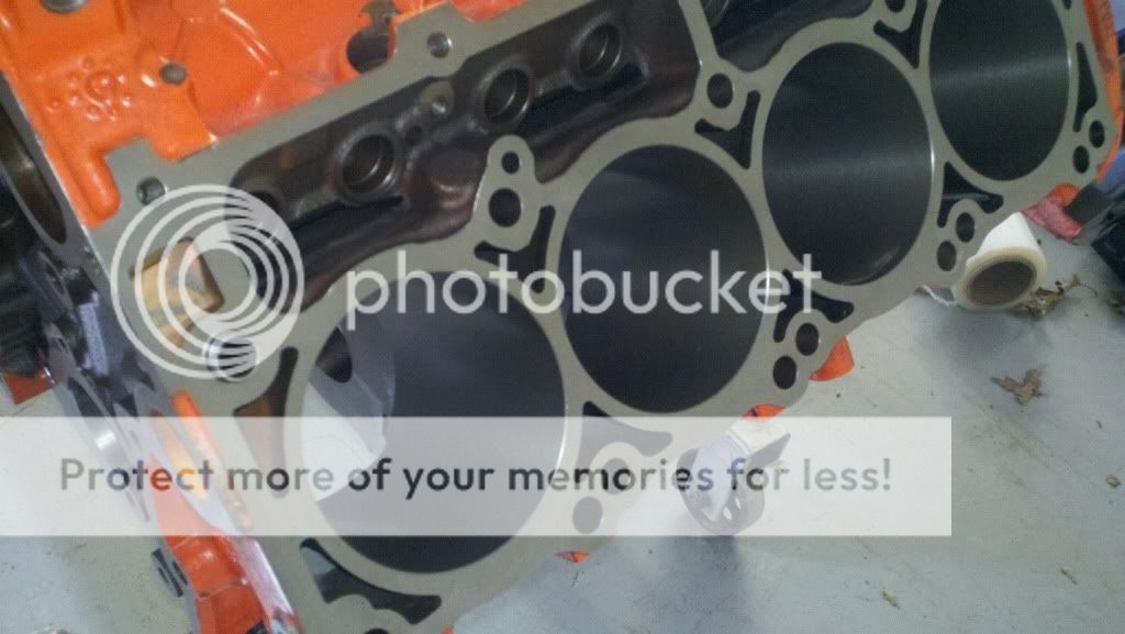

Some of you already know that the 6.1 block has a bore size of 4.055" and cant really go any larger than 4.08" due to cylinder wall thickness. I purchased 5 blocks at an auction a couple years back and this one block stood out as being different. The part number is different, the color is different, the water jackets are actually from a 5.7, but it had 6.1 cast into the side of the block. I sonic tested the block and found that this block could go all the way up to a 4.185" bore and still be considered safe. This was very strange to me so I inquired with a couple of guys in the know about what I had and this was their response.
If that is the block I think it is, it used to be painted black. Of the 6 or so that were made, most were a rough 5.7L bore size with all other features finish-machined to the 6.1L print. Blocks were cast with the 5.7L bores but I thought we stayed with the 6.1L water jacket core and block material. Cam tunnel cores were 6.1L as I recall but we simply deleted the piston jet machining. Also, it seems to me our intent was to put a “P” at the beginning of the casting number, but I may be confusing that with the aluminum block.
Anyway, if this is the block I think it is, it was an early attempt at a heavy duty/race/blower capable block for Mopar with the idea that we might be able to use it in a skunkworx supercharged buzz model. Never went anywhere and they kinda fell off the table when the discussion turned toward the 6.4L variant being conceptualized.
So basically I have come across a 1 of 6 block that is capable of way more than any production 6.1 block out there. We have decided to use a 4.145" bore with a 4.08" stroke to build a 440 that will be able to handle over 1000hp and thats where we sit. Here is a pic of the block.

First number is top side of bore where intake valve sits. Our tester scans the length of the bore and the thinest spot is what we record. A typical 6.1 block untouched is less than 200 everywhere with a 4.055 bore. Now we can build a 440ci iron block hemi and hit it with a 400 shot of nitrous or 20psi.
