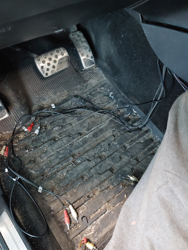

I have a 2014 SRT with the stock stereo and a 2018 Trackhawk with the HK.
The HK was better but I wanted more power like 2800 watts rms 😄
I used a PAC harness to run aftermarket amps that works with both as they have the same heads but the HK has different amps and door speakers.
plastic panel removal tool
clip locations

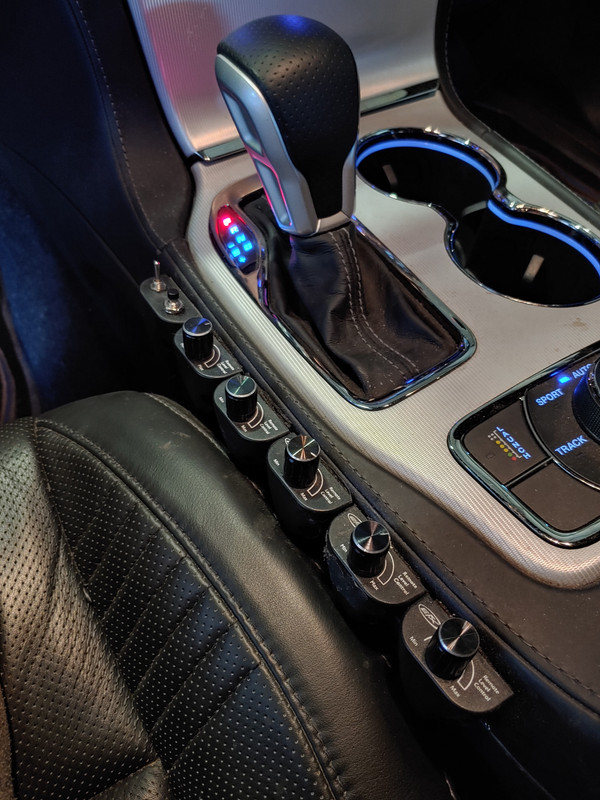

Then I ran the rca outs to some Scosche level pods for tweeters, front/rear doors
under seat subs and rear subs.
9

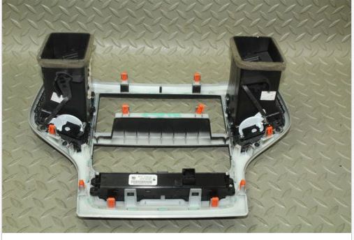

It’s interesting to see the front piece that houses the original setup.
I’ve been speaking with the local guy about replacing the front piece, or what is needed to install a better head radio (or whatever it’s called) with a more refined setup, including what I want the most - decent visible parking sensors so that my wife and I can park my 2018 as we want with spacing to allow us to get in and out of the back seat with our special needs daughter.
SO, if I intend to keep the stock speakers and install a higher-end radio, with smart sensors - so I can see what sensor is beeping WITH a camera, and get crisper cleaner sound, can you summarize what I should do?
No need to take a lot of time.
These pics have scared me to be frank.
I’m OK delving into replacing the front stick bracket, etc. and trying to install a new screen, etc., but I don’t want to get into new harnesses etc.
Can I do this, or is what you are showing ‘really’ the only good way to go?
