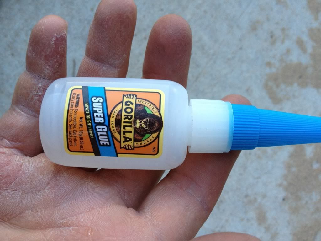

Super Glue:

Go test fit everything and once you're happy everything lines up good, pull the backing off the tape and add a little super glue to the threads on the push fasteners and install!
