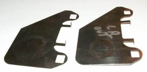

They are stainless steel plates that look black initially because of brake dust. Below are my shims after a little cleanup. These were backing against the composite material that is in fact glued to/part of the factory Brembo brand pads. The shims also seemed part of the pads because (on mine) the factory put a heavy copper colored paste between them that acts like glue, which is probably part of the factories solution to squeal. If you didn’t know better, you’d throw them away with the old shoes (I bet this has happened more than once). The TSB says don’t use the factory shims in the rear, but my experience was that with or without them, brake grease or not, they squealed (and squealed is an understatement!). That’s when I started wondering if the edges, where the backing plate touches the caliper, also needs the rubber coating (which so far I’ve had great results with).Ok well, I have the GS6 pads with cross drilled/slotted rotors and the rear brake squeal is driving me insane.

Can someone explain or illustrate what the shims are?
Are they the metal backing plate built into the back of my pads?
Will removing these help?
