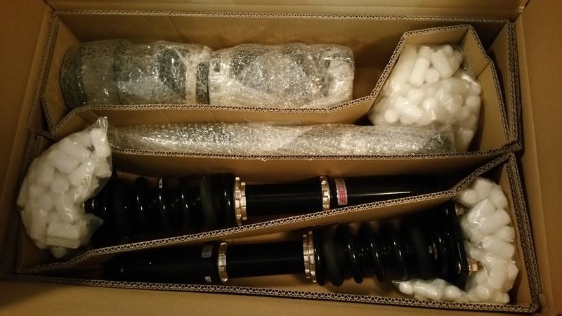

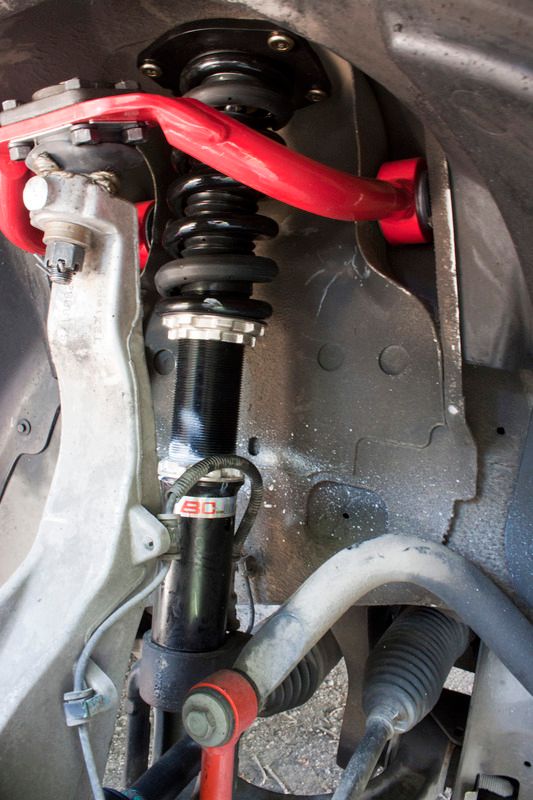

Front shock, rear stock, rear spring, and adjustment spanner (2x in the box):
I was very apprehensive about upgrading my suspension/shocks because; I didn’t know how it would handle/ride after, I was concerned about the durability/craftsmanship (compared to stock Bilstein's) and most of all I was concerned about the safety (daily driven with two car seats). Well, I’m happy to say that the ride and handling have vastly improved (night and day) with the BC Racing Coilover setup. Before the installation my Jeep use to sidestep (badly) over elevated highway joints and bumps (very unsafe feeling). When I first got my SRT8 I took it to the dealer few times to get the side stepping issue fix but they never could figure it out, they just concluded “it’s normal” (no more side step at all with the BC Racing coilovers). The craftsmanship is top notch and the coilovers come with a 1yr warranty (good enough for the price).
I received the packages shortly after placing my orders and proceeded to unbox each item. Being the detailing nut I am, I coated each part with a sealant (not a coating) in order to provide added protection during the (endless) winter months (also made a mess with the white lithium grease). I took the time to play with the coilover adjustments but not the spring preload prior to installation. I ended up setting the rears all the way down but couldn’t find any details what height to set the fronts to I left them stock (for the installation).

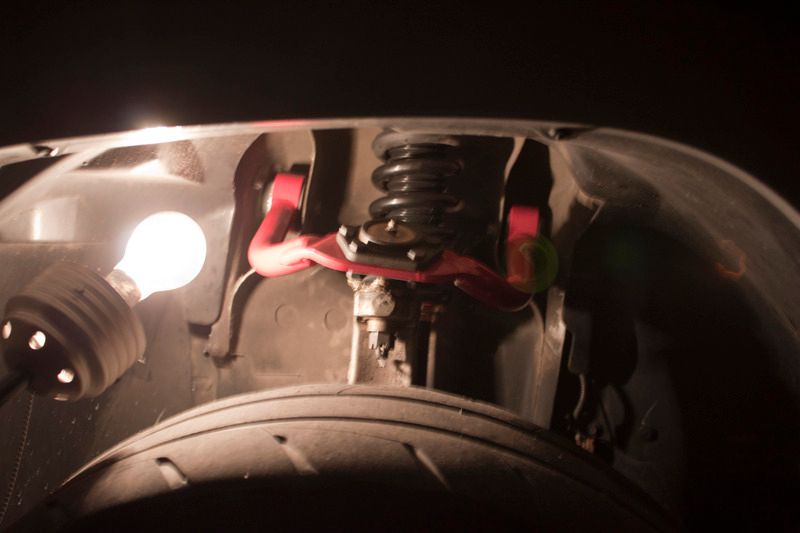

I had the BC Racing coilovers and JBA UCA’s installed by a local installer shop I use and found the installation cost to be very reasonable ($200 for all four corners including JBA UCA – no alignment or adjustments). Upon seeing my Jeep, (post installation) it was clear there were a lot of adjustments to made (front was raised up from stock, and the rear was slammed). Note: removed bump stops and bump stop cups for rear stocks.

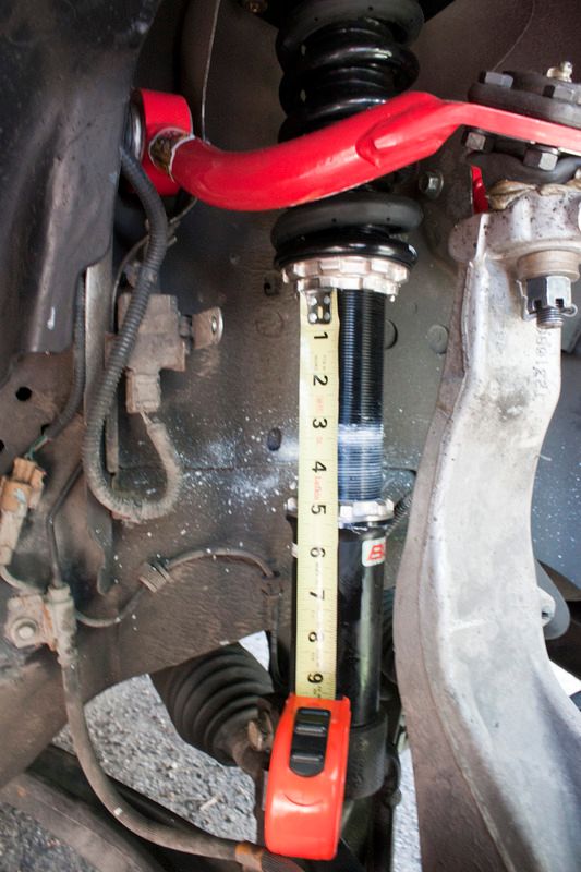

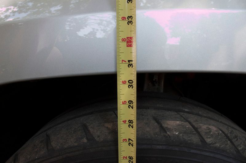

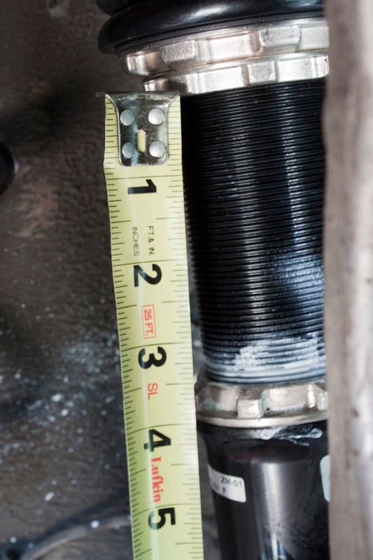

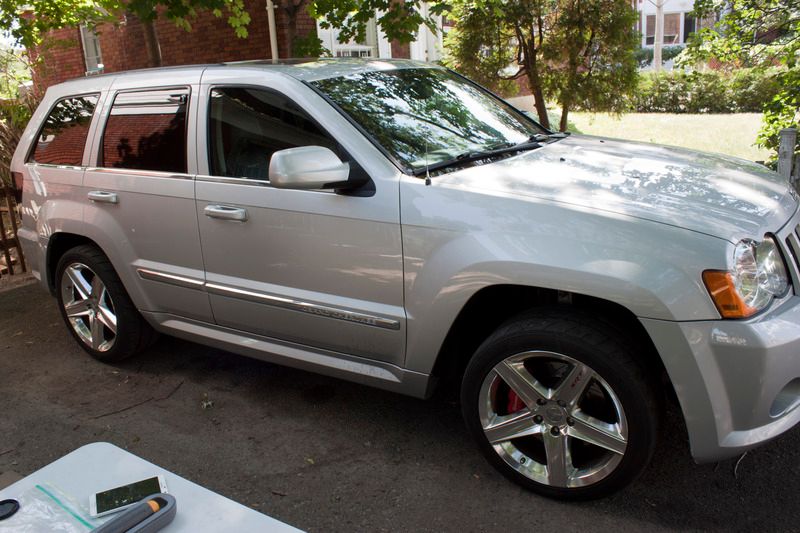

When I got home I started by measuring the distance from the ground (road) to the highest point of the fender arch to get my height (33 inches in the front and 30 inches the rear). I proceeded to lift the front (one wheel at a time) and took more measurements (distance between the lower and middle height adjustment collars). I then adjusted the height to the lowest setting possible and took more measurements (distance between the lower and middle height adjustment collars was 3.5 inches). The lowering is done by loosening the lowest collar (turn counter clockwise), then once loosened use the top-most adjustment collar to lower the sock into the mount (turn the top collar clockwise). This will not affect spring preload because your turning the collar in such a way that it’s tightening against the collar below it and causing the entire shock assembly to turn into the lower mounting point thus reducing the height of the shock and the height of your car (rather than effecting the spring preload). When raising you need to loosen the lower collar again but use the middle collar to extend (unscrew) the shock and in turn raise the ride height (turn middle collar counter-clockwise). Just like with the other adjustment the middle collar will try to tighten against the top collar but can’t so the whole shock will start to turn from its lower mounting base and increase in length without affecting the spring preload. The best part is that you don’t need to remove the wheels to adjust the height!
I didn’t end up making a video how to adjust them because I happened to come across one that was already made:

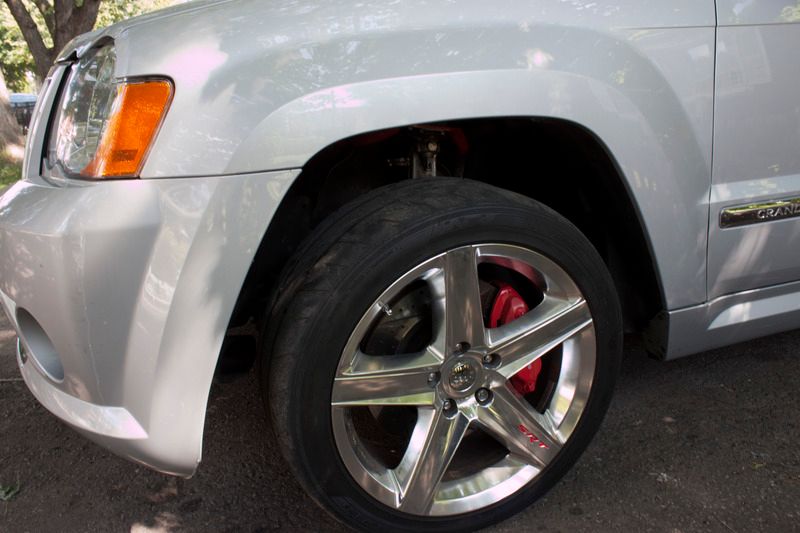

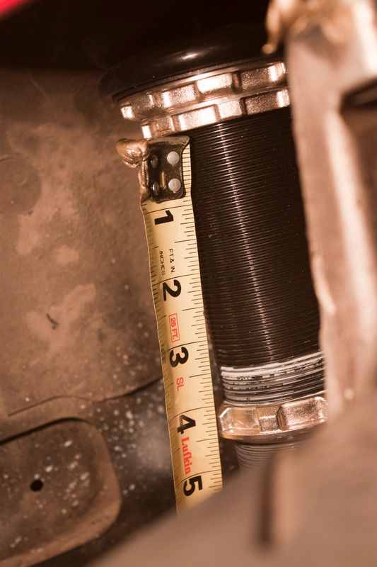

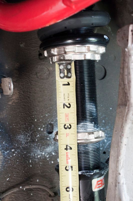

Needless to say I played with the height adjustment till I was blue in the face (6 different ride height adjustments total – for the front). The first thing I did was lower it to the max (3.5 inches collar to collar or 29 inches ground to fender in the front 30 inches in the back with rear adjustment collars still on). I liked the look but not the ride, my JBA UCA were rubbing on the plastic inner wheel guard and I had to cut it a bit to make space. I went for another test drive and was still bottoming out (front shock compressing to its maximum and making a loud thud/bang) on only some large potholes I hit. On smooth roads it was a dream but it was too much bottoming out for my taste so I raised the front 1.5inches (it measured 5 inches from lower adjustment collar to mid collar). Much to my surprise the 1.5 inches of lift on the shock was somehow exaggerated by the other suspension components when dropping the car back on to the street. I went from 29inchs in the front up to 32 ¾ inches from the ground to the top of the fender arch (3 ¾ inches height change for a 1 ½ inch raise on the shock)… I hit the drawing boards with the numbers I had and decided to lower the shocks another 1 inch so that they would be 0.5 inches from lowest possible setting and took it out for a ride…

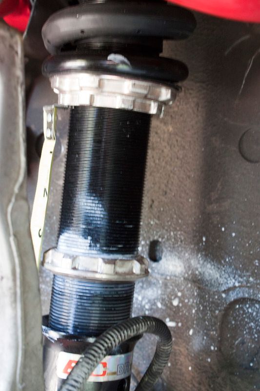

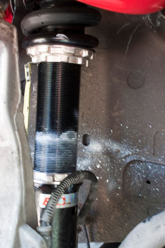

Setting shocks at 3.5 inches collar to collar (as low as they can go):
3.5 inch collar to collar stance:
Setting shocks at 5inch collar to collar:
5inch collar to collar ride height:
Worked night and day to get them set up just right:
Setting stocks at (my) ideal height of 4inchs from collar to collar:
4inch collar to collar stance:
4inch collar to collar ride height:
The test drive was a huge contrast to the previous test drive. This time it didn’t bottom out once and there was no more JBA-UCA rubbing. The ride was sublime! I went back home to take height measurements from the street to the fender and to commence adjust/tune the damping. The final ride height is 30 3/4 inches in the front and 30 inches in the rear around.

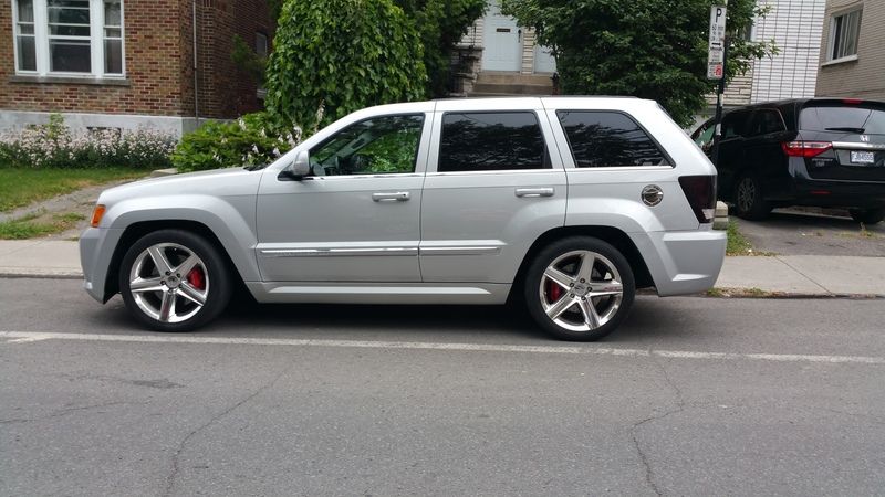

Yeah, I'm more than glad with my purchase. There are some pro's/con's...
Pro's:
Handling never ceases to amaze
Fully adjustable for any situation (road trip, daily, car show, autocross, drag)
Lowered look
Flat cornering/acceleration/deceleration
Much less roll (might have to do with end links and UCA's)
No "dive"
Quality parts that are holding up to my abuse (roads are terrible and I'm low)
Doesn't scrape on speed bumps or at high speeds
Con's:
You'll drive even more aggressively with the improved handling
Handels best if adjusted for driving situation (no "set it and forget it")
Rubbing (minor trim to all 4 splash guards)
Bottoming out (front hits bump stops over sharp drops, rear end hits exhaust)
Below are some pictures I took now that the shocks have settled (daily ride height):
