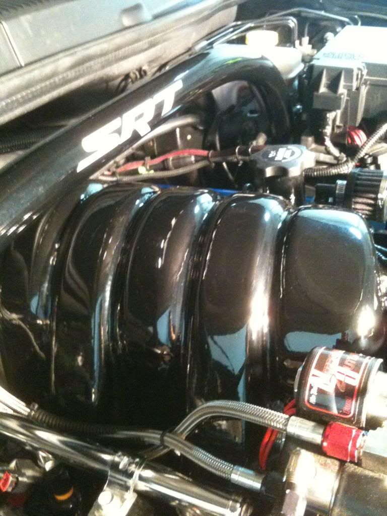

Yup, those links I posted were just to show some prices...there are several vendors here that can help you. I myself have a Bwoody gloss black powder coated ported intake manifold with an 85mm opening.

Looking good there Phil!
