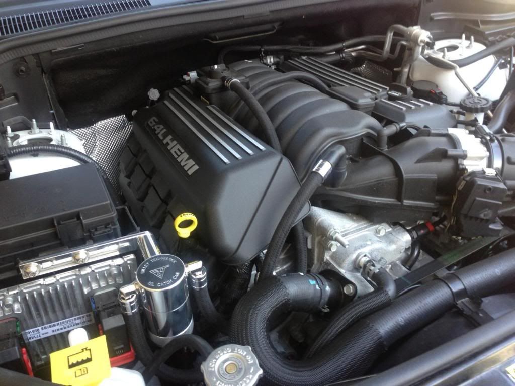

here is my new BT can from Nick... This is the new mount he wanted me to try and the install was very easy.
That's the mount for the 5.7L kit. I've been saying guys should just order up that kit if needed.
Looks good. Hoses seem a bit untidy IMO.

not sure what other way you want me to run the hose besides over the coil cover and I don't like that look.
