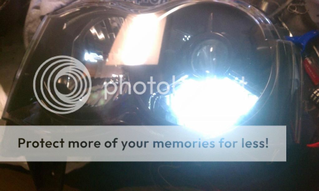

Holy shit that's bright, I already have problems with blinding everyone on the road. I even get cops to shine their spotlight in my face because my HID's are so bright. Good thing is I can spot a cop a mile away with my lights bouncing off their reflectors on their cars.
Can some one post more pics of these turned on ? And are these switchbacks? And what are switchbacks, don't know much about lights lol

I always use switchbacks. They are white with the running lights on but switch to amber with the turn signal.
Here's a pic I have test firing to make sure I had it installed in the socket correctly (they are polarity sensitive):
