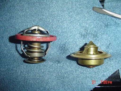

Why is a "bypass" thermostat important?
Bypass t-stats are a must for the long-term health of your motor. The pic below shows a bypass t-stat next to a non-bypass unit. Since the 5.7 and 6.1 HEMI motors use a bypass cooling system, a traditional non-bypass unit will allow hot coolant to bypass the radiator once the engine warms up. This can cause engine damage in the long run. For more information on this subject, please refer to this thread: http://www.are.com.au/feat/techt/thermostat.htm

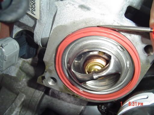

4. Once you drain the coolant in the upper hose, push it aside to expose the OEM t-stat and red rubber gasket.
5. Use a medium flat screwdriver to gently pry the old unit out. Be careful to preserve the gasket. Also, be ready for a final gush a coolant from behind.
