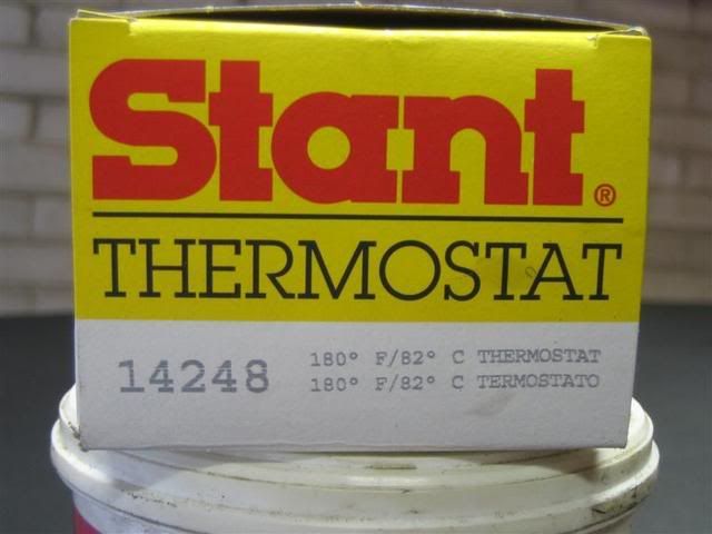

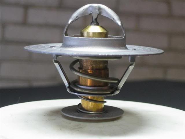

Although I cannot recommend it, the Stant 14248 is 63mm exactly. You will notice the opening is significantly smaller then the Motorad among other things. I would encourage you to consider the Motorad t-stat instead.
