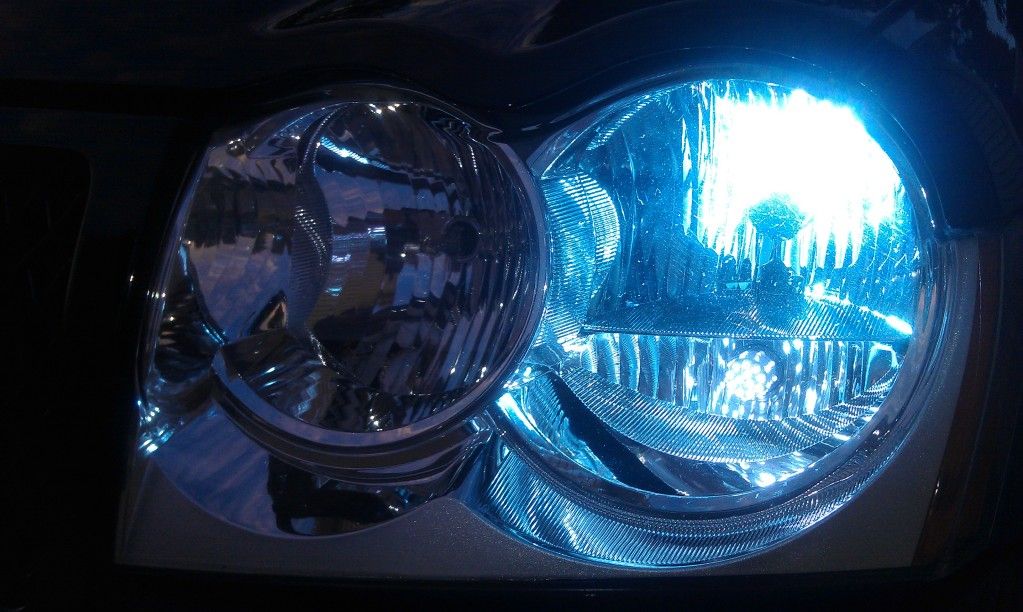

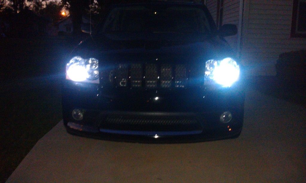

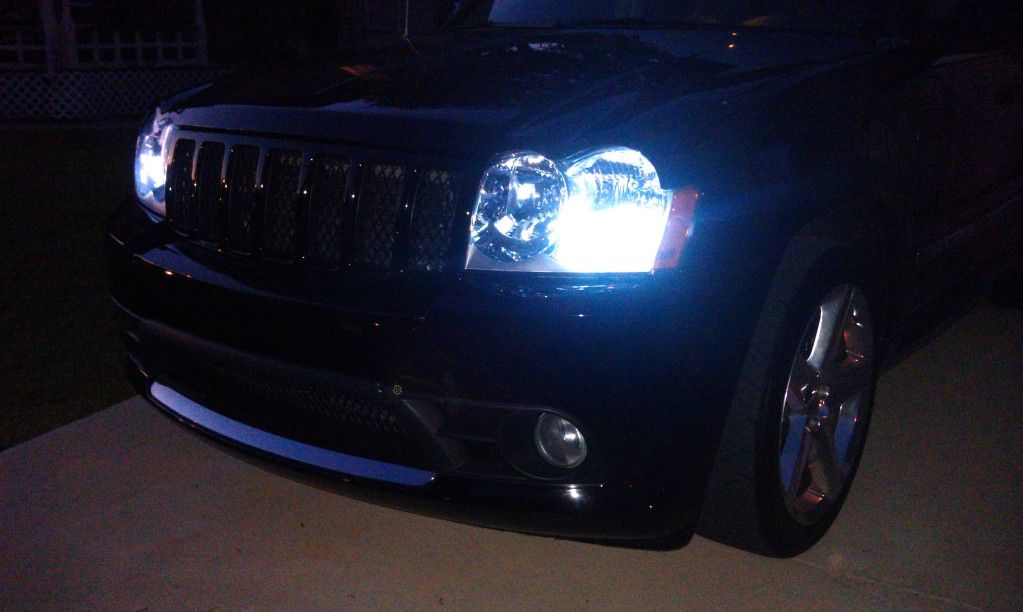

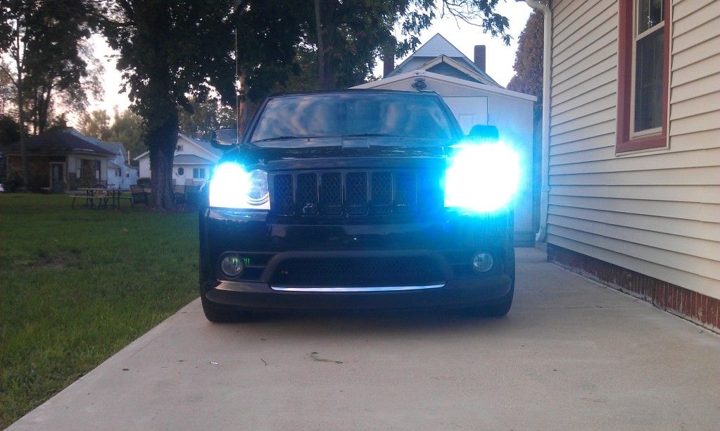

Bump! I just got my 60led turn signal bulbs and they work great. Now I just need to wire in the resistor so a pic would be nice before I try it. I'll probably wire it up tonight after work pic or not, an if I do I will post a pic for ya @RBugnitz. The first three pics are just the 60leds only which are pretty bright! The last 2 pics are when I tested the leds matching the 8000k hids, pretty close I think.
